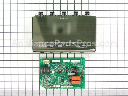

Check the wires and wire connections under the hinge cover. Make sure the pins in the connector are not backing out of the connector. Check for a constant 14 Volts DC on the dispenser board J5-1 to J5-3.
If both are good, here's the service kit you need to order:
W10864261 Cntrl-Elec
