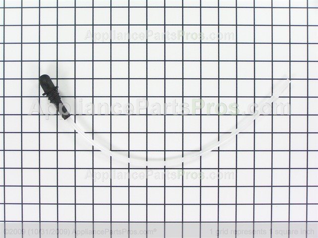

I'd first check your ice maker fill tube for ice blockage, and check to make sure you didn't forget to re-connect the fill tube heater after you replaced the ice maker.:)
Here's the ice maker fill tube for your model:
Tube-Water W10815476
Watch this video to access it:

No, because you said it sounds like its filling, once you access that fill tube assembly its highly likely you will find it clogged with partial ice.
