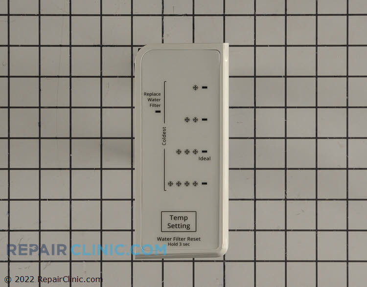

Here's your main control board: Contrl-Box W11203924
Its located inside the refrigerator where you select your temperature setting. Is that lighting up or dead?
This is a photo of it:
Also you can pull the refrigerator out from the wall and remove the lower back access panel and see if your compressor and condenser fan motor(next to the compressor) are both running. You can put your hand on top of the compressor to see if its vibrating and warm.
Thank you so much for your reply! The control box is lighted on the cooling settings it is normally set to. I'll pull the back of the fridge and get back to you asap with a response on that. Thanks again!
