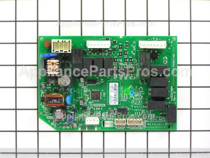

134,082
Redmond, Oregon
Ok, then seems to indicates the control board is not working properly if STEP 5 is not doing--->Wait until the UI displays “-5”
Cntrl-Elec W11035841
134,082
Redmond, Oregon
It also has to be under 8 degrees F for the ice maker to cycle the ice out automatically. Do you have a freezer thermometer you can put in the ice maker compartment to see what the temperature says it is?
Did you check your ice maker compartment temperature with a freezer thermometer TO make sure its 8 degrees or less?
Hate to see you spend $250 on a control board if the 8 degrees or less it needs to cycle automatically is the problem, see what I mean?

Sorry I forgot to hit the post reply on the same night I first tried the procedure, the ice maker has been making ice since I tried the procedure. So despite the IO control not outputting the correct information it did still work.
