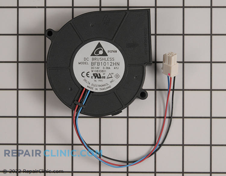

In the ice maker compartment itself its 25 degrees? That's way too warm, that's why you are getting the E1-No cooling error. It needs to be 10 degrees or lower at all times in the ice maker compartment or it will never make ice.:)
I did test 36 and could hear the fan running. I cycled it on an off a couple times. It's quiet but I could feel it when I opened the ice chute door.
I think there is something wrong with your ice box fan motor, or the control board that powers it because it should be running at all times in the ice maker compartment to keep is under 10 degrees to make ice. You may want to see if that ice box fan runs, even when not in TEST 36 mode.
Here's the ice box fan for your model(Video to get access/replace it is in the part link):
Fan Motor W10846539
--->The ice maker gets its cold air from the refrigerator evaporator. There is a air tunnel that cold air flows up to the ice maker and that ice box fan blows the cold air onto the ice maker.

Well the parts arrived. New fan motor and new dual water valve. Both installed Wednesday. Happy to report today.. Ice bin full
Thank you for you expertise. Cheers
134,110
Redmond, Oregon
Excellent Jay, glad to hear the new ice box fan motor and new dual water inlet valve fixed it.(y)
