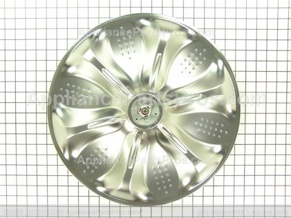

thanks jake i do not see anything in that manual either. at this time i trying to get the tub out and the agitator is a bear. is there a tool for that? i put a puller on it and that will not stay on the rim to much taper i guess so i put a 1/4" bolt in the shaft and tried a small die bar and that is not helping so i sprayed it with wd40 and let that soak but so far that is failing. so there must be a tool to do this? i do not want to put screws in the holes and try to yank it out as then i have to deal with burs. thanks
thanks i seen that but mine is stuck on there tight. i put a small screw in the hole and then put a prybar on that to put the force into the shaft and i just could not get that think off. now i hope i did not damage it by that force i put on it. if i did then i will just rip the plastic shaft housing apart and get another swash plate and cover. i was tyrin gto get it apart to clean the drum and tub as it has not ever been cleaned. so i cleaned what i could and did a tub clean with bleach. it ran all the water out and then gave me a code ue i thing it was. i turned it off and lets see how it goes friday washday. oh while i had the top open i did a pusk test on the tub supports at each one and one rebound slower that the rest. and in the bub clean when it went into spin it started to look like it was goin g out of balance with just water in it. it looked like the tub was goin like if you grabbed the center and moved it in a circle. but that could be a normal way it spins out. thanks
jake i think i may have come up with a way to get that off swash plate off. i will take my 3 jaw puller and put a hose clamp on the top jaws to force the lower jaws out against the plate and see if i can get it to pull up off the spindle. if it works i will take a photo of the setup for your future reference. it may work and then it may not but it is should be better than poking picks or wires into the holes. if all that fails i may have to get some of those airbags that i saw in another video and pump it up and put hot water on the center and see if that works. but using a puller with a clamp on the top of the jaws to hold the lower jaws into the plate should work. i will let you know. thanks

jake that failed. all oit did was bend the top metal. it is on there good. so i will ebay one with the cap and then cut that one out with a hole saw. the tub smell musty so it must need to be taken apart and deep cleaned. i tried hot water and hot air gun and even tried to pry som on the inside to see if it may break the bond and it all failed. to bad thanks for the help when i get it apart i will post photos of what i had to do and how dirty it is.

jake if i have to remove it i guess i will just have to play around with it. it i find another one cheap i will just cut this one off and clean everything and then grease it good and reinstall the new one. oh well if i had a service person out my guess is they would have to break it to get it off. so for now it is what it is. thanks for the help given.
Yes, this is true. I've had many on other brands I've had to break off before myself.
i was toying with the idea of setting some wood type screws into the plastic around the hub area and pulling on that but my guess with the luck i have had so far all it would do is break or strip out the screws. so now i have to see if the cap will stay in as the alignment pins broke off. if it pops off i will try silicone to hold it on if that fails then jb weld it thanks
