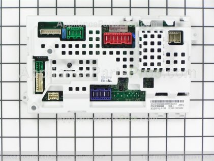

I don't know Dave if it is or not, the Rev. letter would indicate that. The one in the photo above looks to be a Rev. J
