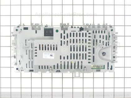

At any rate, it sounds like the control board has gone faulty.
Here's the control board for model WTW6800WW1, but its No Longer Available:
WPW10249237 Electronic Control Board
