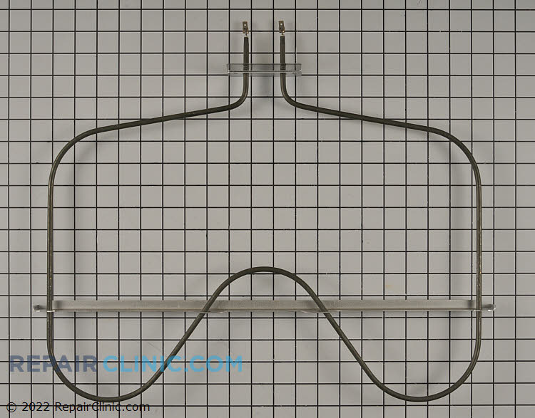

Does the bottom bake element come on at all when set on BAKE?
If not, pull the range out from the wall, then disconnect power to the range, then remove the back access panel and you will see the bake element terminals, then ohm test it first to make sure its good.
Here's the bake element for your model:
Bake Element W11182108
Here's how to ohm test it:
If the bake element ohms good, then the problem is the clock/oven control board: Control Assy,lcx 1.0,ELE,PYRO,WHT,WP W11546660
